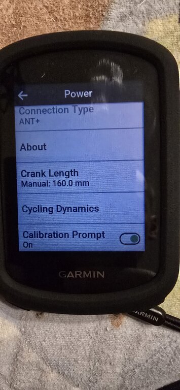

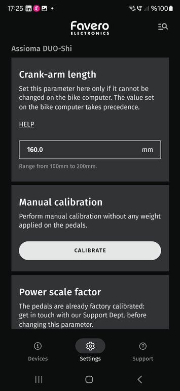

172.5 olan yer 160mm oluyor mu ?

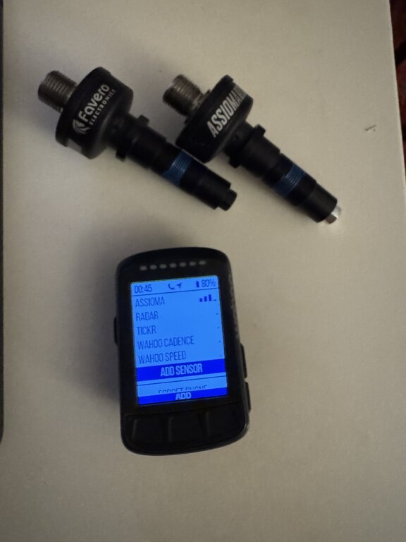

Assioma DUO-Shi alacaksanız dikkat, bir sporcum sadece sağ tekini aldı, Garmin ile çalışmadı, tüm işi sol taraf yapıyormuş.
Sağ tek mil satışı da var, ondan uyarayım dedim
Firmadan gelen yazı aşağıda
Answering your question, I can confirm that unfortunately it is not possible to proceed as you requested as the "master" is the left sensor, all the information must pass through it and it is the only sensor that can communicate with the head unit or the apps.
Therefore, it is not possible to use only the right pedal by itself, as it has to be always synchronized with the left.
