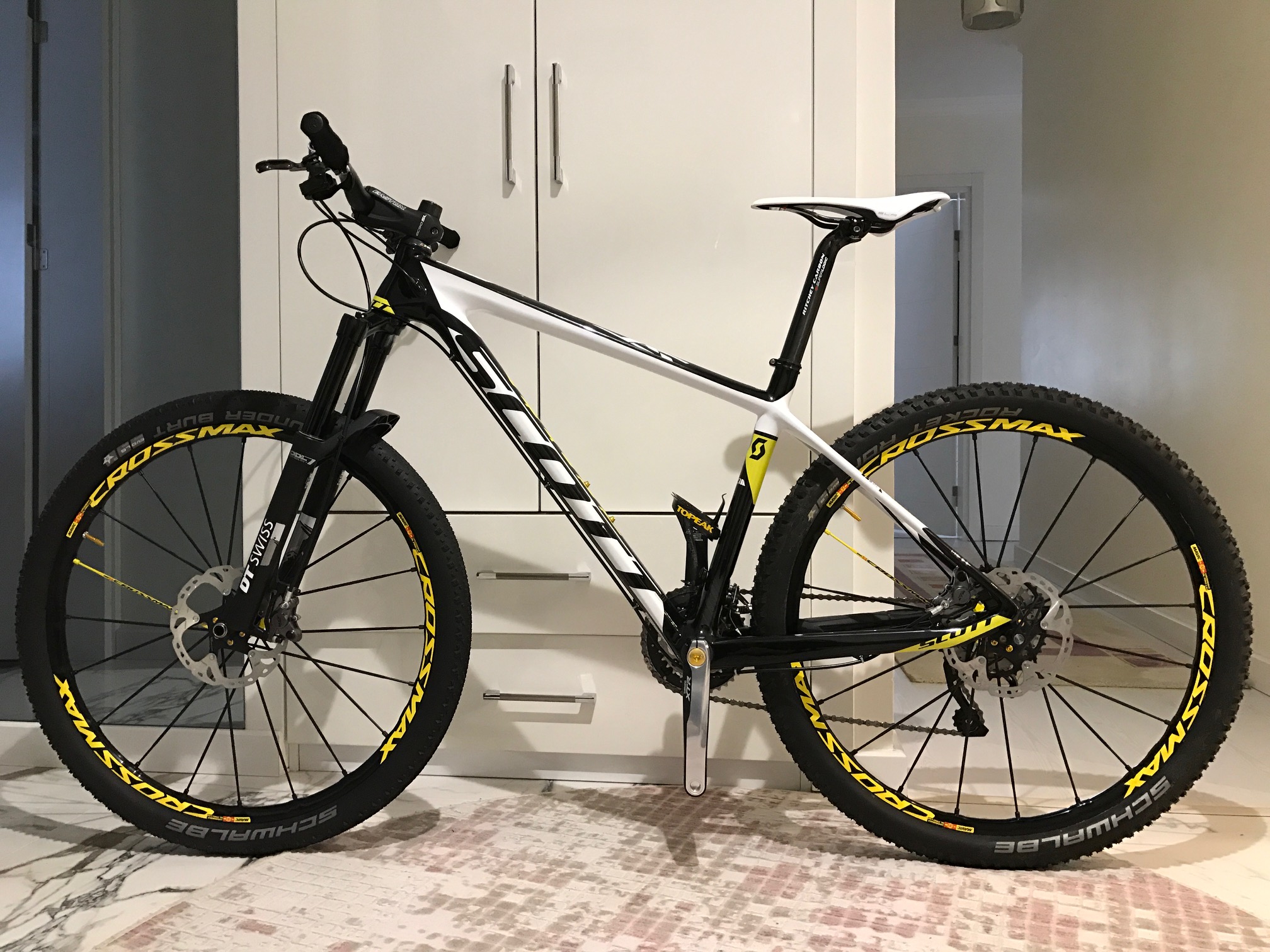

    Merhaba;
    Scale 720 kadro hariç komple ekipman değişti. Masraflı bir proje oldu fakat benim içime sindi. Amatör kullanıcıyım , sonuçta yarış vs girmeyeceğim ama bisiklet bende hastalık ve hobi. Schwalbe Thunder Burt set ile birlikte pedalsız ağırlık 8,88kg şuan.
    Kadro: SCOTT Scale Carbon / IMP technology / HMF / Tapered HT / PM 160 Disc / BB92 / IDS SL DM dropouts for 142 × 12mm / SDS Shock Damping System
    Kadro : "SCOTT Scale Carbon / IMP technology / HMF / Tapered HT / PM 160 Disc / BB92 / IDS SL DM dropouts for 142 × 12mm / SDS Shock Damping System
    Maşa : DT Swiss OPM O.D.L 100mm - 27.5" Fork - 41mm Offset - Tapered - 15x100mm - 2016 - black
    Furç Seti : Ritchey WCS Carbon Logic Zero Press Fit 1-1/8-1.5 inç Taper Integrated
    Ön Vites : Shimano XTR M985 E2-Type 2x10 Front Mech
    Arka Vites : Shimano XTR M986 Shadow+ 10 Speed Rear Mech
    Vites Kolları : Shimano XTR SL-M980A Dyna Sys Shifter Pods/Levers Pair 10s
    Ruble : Shimano XTR M980 10 Speed Casette
    Zincir : Shimano XTR Chain CN-HG901 11-speed 116 Links
    Ön fren : Shimano XTR M9000 Race
    Arka fren : Shimano XTR M9000 Race
    Aynakol : Shimano XTR M985 Race 10 Speed Double Chainset
    Göbek : Shimano SM-BB71-41A / shell 41x89.5mm
    Rotorlar : Shimano SM RT-86M 6 Bolt Rotor 180mm F/180mm R
    Disk Adaptörleri : Shimano XTR 180mm Ön SM-MA90 Rotor Adaptörü (Post/Post) x2
    Sele : Selle Italia SLR Kit Carbonio Saddle
    Sele Borusu : Ritchey UD Carbon Super Logıc Single Bold
    Sele karbon adaptör : Scott Stubby Carbon adapter
    Sele Kelepçesi : Token Titanium pro
    Gidon : Easton EC90 SL Carbon
    Gidon boğazı : Easton EC90 SL 635mm Carbon
    Elcik : Ritchey WCS Truegrip Ergo Foam Grips
    Ön jant: Mavic Crossmax SL Pro Limited Edition 27.5''/650B 15x100mm
    Arka jant : Mavic Crossmax SL Pro Limited Edition 27.5''/650B 12x142mm
    Lastikler : Schwalbe Thunderburt EVO / 2.1 / Liteskin / PaceStar compound
    Amortisör Mili : 15x100mm ML
    Kadro Mil : DT Swiss syncros 12x142 mm
    Kadro Kulağı : DT Swiss syncros
    Kadro Koruyucu : Scott
    İç astik : Maxxis Lite

    Öncelikle hayırlı olsun hocam güle güle kullanın size naçizane tavsiyem arkayı 160mm rotorla değiştirmeniz hele ki thunder burt gibi bir lastik kullanacaksanız 180mm rotorun size ağırlıktan başka getirisi olmayacaktır(Kendim de yaklaşık 1 yıl ön arka 180mm kullandım.). Onun dışında jantlarınız kadroyla çok uyumlu olmuş arkadaşımda aynısının stealth modeli var kendi bisikletimde de deneme fırsatım oldu akıcılık, rijitlik ve ses olarak kullandığım en güzel setlerden biriydi.

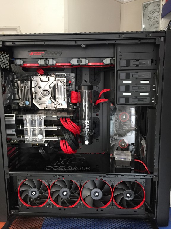

    Brandybuck benim nickim. Extreme Overclock tarafından tanıyor olabilirsin.:) DH , HWA vs..
    Renk konusunda herzaman zevkli olduğum söylenir.Madem öyle konu dışı olacak ama evden bir resim daha paylaşayım.:)
    [​IMG]

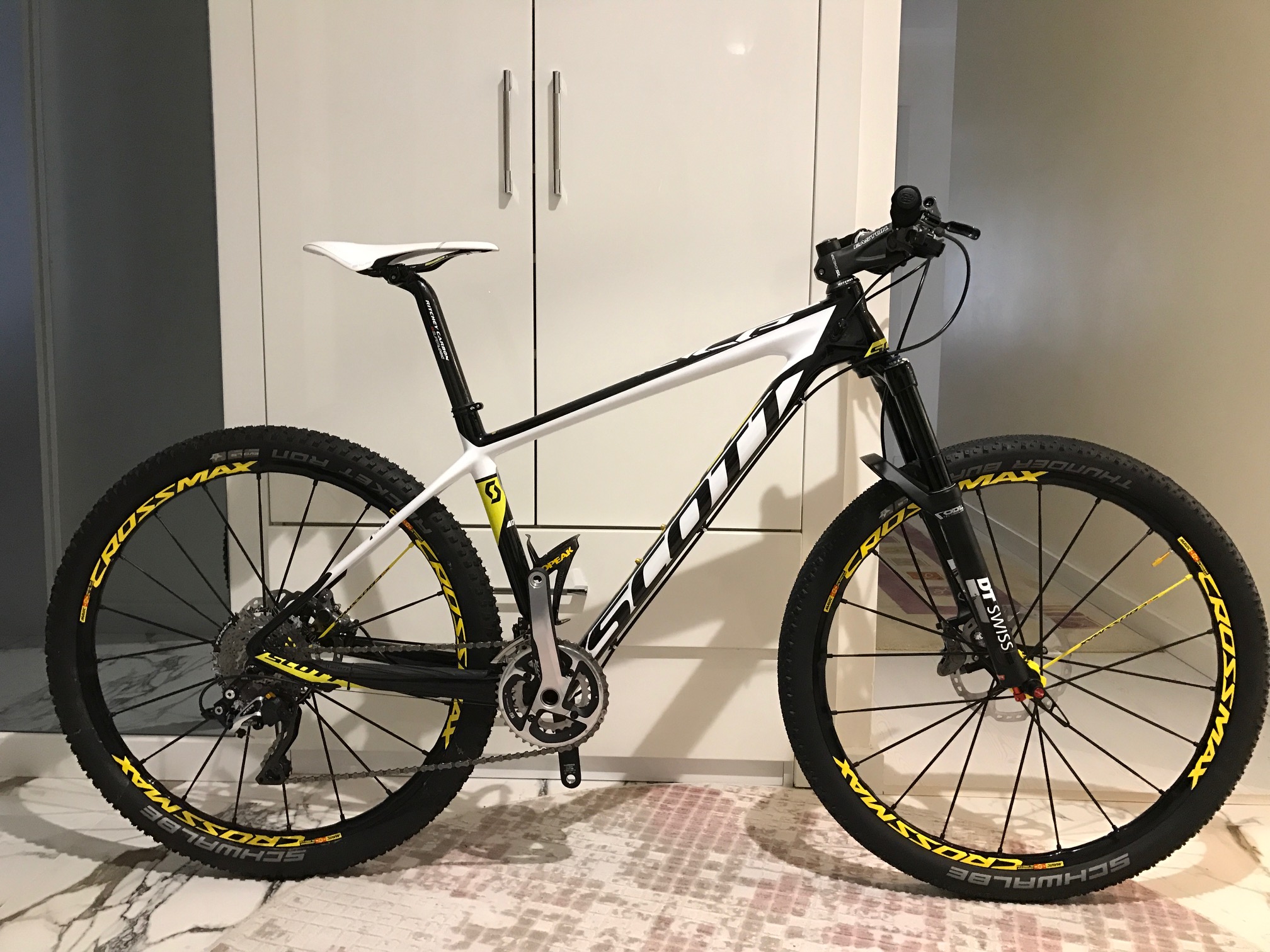

    Şuan tubeless 'e geçtim ve toplam 8.72 kg pedalsız ağırlığı var.
